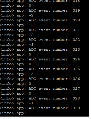

ADC channel reading values when connected to ground
Hope you are doing good.
I run the SAADC signal to from the sdk and observed that  when the adc input is connected to ground, the adc reads few random negative value( reference image attached below). is this a common behavior when the analog input is connected to ground?How do i correct this so that i do not make any measurement errors?
Thank-you

    This is due to noise and offset error. Do a calibration and see if it helps.

    How often you should call the calibration routine depends on how often the temperature will change. If you don't expect any temperature change then it's enough to do it once at the start.
    I've updated my previous answer with the correct URL. See the example for a reference on how to implement it.

  • Hi Jared, thanks, I've succesfully implemented the calibration steps thanks, of course I still get negative value when the input is directly wired to the 0V and as I'm reading through the forum I'm clipping every negative value to 0.
    I'm just curious how the offset calibration work, I think is done completely inside the ADC module by disconnecting the ADC input from the external pin of the chip, I'm right?

    We do not share information regarding the details of the internal calibration routine. What you might be observing is ground bounce. Have you tried using differential mode, and connecting the second pin directly to the GND of the source that you're measuring?
