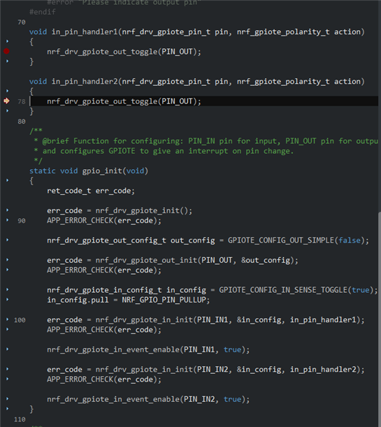

  • Hi Jose,
    I have verified that this works just fine with the pin_int_change example in the SDK. I added another IN pin configuration to match your use case and i can see that the second pin handler is called as you can see from the snapshot where the breakpoint is being hit.
    My guess is that you are verifying this in the debugger by building your code in release mode and due to max code optimizations, the debugger thinks that your handler2 code is not being used.
    I suggest you test this by compiling your code with debug settings with no code optimizations.
    Attaching you the C file i tested this with.

  • The actual code is not exactly the same because it is already integrated into our codebase, so the calls to these statements are in different files because they are setting up different features, but logic-wise they are doing the same operations.
    I turned off all the optimizations and it's still not working, the bit fields in the register CONFIG[1] are still incorrect, as Kyle pointed out. Looks like that when we call "nrf_drv_gpiote_in_init" more than one time it messes up the configuration of the GPIOTE peripheral, and in our case, we can see this by checking that the MODE field in the CONFIG register is being changed to Task for some reason when it should be Event.
