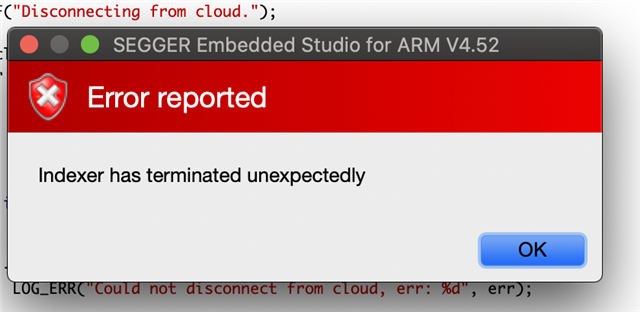

I have been struggling with Segger studio arm v4.52 nordic edition as it is very buggy and keeps failing (indexer failing every time).

    I always get this when I open SES Nordic Edition version 4.52 and cannot find declaration or definition of any function or variable.

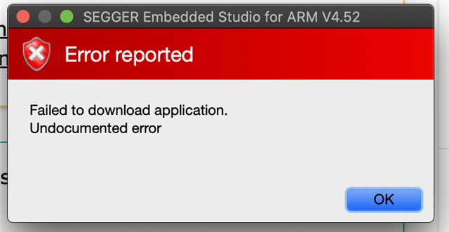

    I get the following error when i build and run asset tracker example. It builds but fails to flash it.

     Yes, this is correct as it is not Nordic Edition. We are aware of issues with SES v4.52 Nordic Edition and are working to fix these issues. Unfortunately, I do not have any timeline for when this will be fix or a new version is ready.
    What guide did you follow to install NCS and Segger Embedded Studio? Did you use the Getting Started Assistant or the Toolchain Manager in nRF Connect for Desktop? Have you configured SES correctly?

    No, this is correct as the official Segger IDE v4.52C is not supported/built for NCS. In SES - Nordic Edition you have several Nordic specific features e.g. the nRF Connect tab under Tools -> Options. Have you configured this correctly as described in the last step of the Getting Started Assistant?
    If you are not able to use the IDE (SES - Nordic Edition), then I suggest building using West in the command line. If you have set up everything correct, you can open a terminal in macOS. Navigate to your asset tracker application:
    source <NCS root folder>/zephyr/zephyr-env.sh
    cd <NCS root folder>/nrf/applications/asset tracker
    west build -b nrf9160dk_nrf9160ns -d build
    west flash
