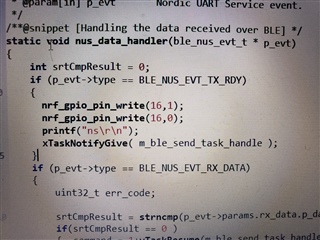

I am sending task notification from nus_data_handler when in get BLE_NUS_EVT_TX_RDY event

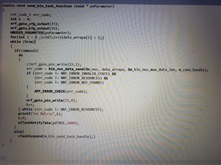

In a seperate task , i am sending  ble packets (244bytes) by using ble_nus_data_send...

    Here is my sender task , it sends some sort of data until NRF_ERROR_RESOURCES
    And here ; i give task notification after i receive BLE_NUS_EVT_TX_RDY

     * @param[in] p_evt       Nordic UART Service event.
        int srtCmpResult = 0;
        if (p_evt->type == BLE_NUS_EVT_TX_RDY)
          printf("ns\r\n");
          xTaskNotifyGive( m_ble_send_task_handle );

    char data_arrayx[247];
    static void send_ble_task_function (void * pvParameter)
        ret_code_t err_code;
        int k = 0;
        UNUSED_PARAMETER(pvParameter);
        for(int i = 0 ;i<247;i++){data_arrayx[i] = i;}
        while (true)
          if(command){
            do
                err_code = ble_nus_data_send(&m_nus, data_arrayx, &m_ble_nus_max_data_len, m_conn_handle);
                k++;
            } while (err_code != NRF_ERROR_RESOURCES);
            printf("wt %d\r\n",k);
    	k=0;
            ulTaskNotifyTake(pdTRUE,1000);
          else{
            vTaskSuspend(m_ble_send_task_handle);}

        // tried 1,2,3,4,5 task priorities but the result is same
        UNUSED_VARIABLE(xTaskCreate(send_ble_task_function, "BLESEND", configMINIMAL_STACK_SIZE + 200, NULL,3, &m_ble_send_task_handle));
        vTaskStartScheduler();
        for (;;)
            APP_ERROR_HANDLER(NRF_ERROR_FORBIDDEN);
    I see a few very relevant defines here. Specifically, you have configured a 400 ms connection interval. What happens if you set MIN_CONN_INTERVAL and MAX_CONN_INTERVAL to (say) MSEC_TO_UNITS(30, UNIT_1_25_MS) instead of MSEC_TO_UNITS(400, UNIT_1_25_MS)?
  • The problem solved as I implement your suggestion. so what is going on here? When I set it to 400, tx speed slows down after approximately 16 seconds, when I set it to 30, I have tested for 5min continuously and there is no significant slowdown issue. I can understand if 400ms setting would be the reason of low throughput but i really can not figure out why it slows down after 16 seconds.
    You need to add more logging or use a sniffer trace to answer that question properly. The reason is that the nRF can only request connection parameters when it is a peripheral, and it is the central (phone) that decides. So you need to look at what happens on the link layer to know why the connection parameters are adjusted to what and when. But it is clear that you had configured the nRF to request a 400 ms connection interval, so the only thing that you don't know is why it toke this long time before it happened.
