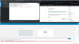

    We had one of Nordic's FAEs (George Xiong) come over today to have a poke at things here.
    He brought a couple of NRF9160-DKs with him, and the NRF Connect app says the same thing (Unsupported device. The detected device could not be recognized as neither JLink device nor Nordic USB device) even with the official DK plugged in to my machine.
    nrfjprog recognised it (and the nrf9160) just fine, but apparently nrfjprog can't flash modem firmware.
    He was unfamiliar with the pynrfjprog library and thus unable to help make any progress there.
    His computer was also unable to flash the modem firmware, but we scavenged a colleagues' laptop which was able to do it - so that gets us over this roadblock for now but isn't a sustainable solution.

  • I made /opt/SEGGER/JLink a symlink to my JLink_V680a folder, and NRF Connect programmer is rather happier about it (I'm not even sure how it was finding the older version before, it never asked me where to look), but pynrfjprog doesn't seem to have improved.
    I've tried with both a regular JLink (possibly a knockoff) as well as an official Nordic NRF9160-DK delivered by your FAE today.
    I'm using Gentoo because it's the only distribution I've tried that doesn't fight me when I tell it what I want.
    It certainly does seem like your software needs improvements in its error handling, a simple "The JLink library at <path> is too old, please update" or "The JLink library can't be found in <searchpath>" would have saved a ton of drama - with the specific path and the issue with them presented in this manner, it would take but a moment to drop a symlink there.
    PS: why aren't you using environ[LD_LIBRARY_PATH] for this? It exists specifically for this exact purpose, and I already have my JLink library path listed in there so nrfjprog can find it.
  • I reinstalled pynrfjprog and it seems to be working now.
    It seems like my problems were caused by your software totally ignoring LD_LIBRARY_PATH and instead trying to silently use a hard-coded path outside my home dir, coupled with a complete lack of usable error checking and reporting.
    Now I'm finding that the modem won't talk to anything but I'll make a separate post about that.
