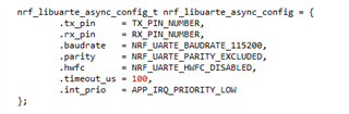

    And used them in the libuarte config function  :
    nrf_libuarte_async_config_t nrf_libuarte_async_config = {
                .tx_pin     = TX_PIN,
                .rx_pin     = RX_PIN,
                .baudrate   = NRF_UARTE_BAUDRATE_115200,
                .parity     = NRF_UARTE_PARITY_EXCLUDED,
                .hwfc       = NRF_UARTE_HWFC_DISABLED,
                .timeout_us = 100,
                .int_prio   = APP_IRQ_PRIORITY_LOW
    But didn't read nothing ...
    What am I missing ? Should I use another example ?
  • Hi
    There is no need to manually call the nrf_gpio_cfg_xxx functions when using libuarte. When you enable the UART the pin configuration will be overridden by the UART module.
    I was able to move the TX and RX to pin 11 and 12 simply by changing the .tx_pin and .rx_pin defines in the libuarte config struct.
    I tested it just to be sure, by connecting pin 11 and 12 on one kit to pin 6 and 8 on another kit (in order to connect these pins to a PC through the Segger chip on the second kit).
    Are you still having issues with it?

  • Hellooo,
    I tried your solution, copied a brand new example, changed my libuarte config, connected it to the Arduino and it finally worked !
    It was that simple finally ....
    I still had some transmission issues with baudrate at 115200 and 38400, it works really good at 9600, but I think it might more be an echo problem from the Arduino and the AltSoftSerial/SoftwareSerial libraries, so my issue is solved !
