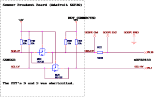

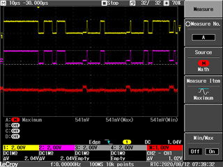

Is there any way to reduce the TWIM SDA line input current? We use a 1.8V I2C sensor (connected via level shifter) that can sink 2mA max. So, the communication will fail because the sensor can't pull the SDA line to LOW level. The current (measured between sensor SDA and nRF52833 is about 10mA when the sensor is trying to pull the SDA line LOW.

  • No, the voltage drop is every time when the sensor try to pull the SDA line LOW. In this case to ACK the I2C device address (9th clock).
  • Thanks, it's clear to me now that p0.20 likely sources the excessive current. There are two options, either the GPIO is in the output-high state or the GPIO's ESD protection diode is blown due to over-voltage (short-circuit). Since you can reproduce this issue on the DK it's likely not an over-voltage issue.

    Please note, there are 4 more I2C devices on the custom board. The communication with devices works w/o issues. Perhaps, this is because the devices can sink at least 10mA.
