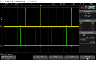

When I trigger TIMER 1 and 2 at 100 us, it works fine, like in the following picture. The pulses are the CLK signal of each SPIM, 16 bits each. I am quite sure the interrupts are generated at the same time but one is delayed due to the other one's priority, but that's good enough.

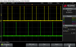

But ideally I would like TIMER 1 to tick every 100 us and TIMER 2 every 50 or 25 us. When I change that (SPIM 2 being the yellow trace), it looks like this, SPIM 2 triggering whenever SPIM 1 allows.

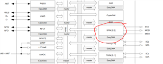

Since there are four possible instances of SPIM, I had the idea they would work independently, but checking the Product Specification (https://infocenter.nordicsemi.com/pdf/nRF52840_OPS_v0.5.pdf, page 12), the block diagram shows only one physical SPIM peripheral:
In a nutshell: Is it somehow possible to start more than one SPIM transfer at the same time (if so, how?), or only one SPIM transfer can be started because they share the same physical peripheral? Or another explanation?

  • An SPIM instance is a part of a serial peripheral unit(UART/SPI/TWI), of which there 4 (I believe) with different UART/SPI/TWI capabilities. This means that you can have up to 4 SPIM instances running independently, though you will then not have access to any UART or TWI instances.
    There might be a limitation to running two SPIM instances at the exact same time and that is the EasyDMA bus, see Memory and EasyDMA.
    As the two SPIM peripheral's will act as bus masters, and each RAM block is controlled by one slave, you might get a wait-state as the EasyDMA slave can only serve one master at a time. I assume this wait state does not exceed one 16MHz clock cycle (PCKL16M). ie one of your SPIM transfers might get delayed by 62.5ns.
    If that's a problem then you can place the buffers for each SPIM peripheral in separate RAM blocks, then you should not have any DMA collisions.
  • Thanks for the answer. So I take from it that it is essentially possible to make them run together, those are good news.
    I will take a look at those links you sent, but as for now, the delay between transfers is around 37 us instead of 62.5 ns (which would be tolerable). I just realized the images don't have a enough resolution to see that.
    I will try placing the buffers in separate RAM blocks, and get back to you if the delay disappears.

  • I just finished doing this but implementing two PPI channels instead, one for each SPIM.
    I must admit now I can achieve resolutions of 5 us and both transfers can be started at the same time (but for a few ns) in free-run.
    The problem is when I use the callback function of the timer to update the buffer, apparently that introduces that delay, any timing less than 100 us destabilizes the synchrony.
    But I cannot think of a workaround since that SPIM controls a DAC and I need to change the buffers and time at which I trigger the SPI transfer dynamically.
