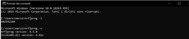

I have problems in the configuration of nRFgo Studio and the communication of the DK with my sparkfun breakout of nRF52832. After several tips taken form this blog and on the web i tried to install the latest version of the Jlink Segger and the one of the Command-line-tools. Than i installed the NFgo Studio. The error was "make sure nrfjprog is installed". I tried different installation orders but nothing changed.
So I tried to first install the Studio and than upgrade the segger jlink with the latest version( V682c). Now the device is detected but when i erase all the error showed is "unable to find or open the jlinkarm dll". I'm running out of ideas, can you help me guys?
    Going back to your original ticket: what do you see when you write the command : ' nrfjprog -v ' in a windows command prompt, what does it output?
    We will need to make sure that nrfjprog is properly installed before we can proceed with the installation troubleshooting.

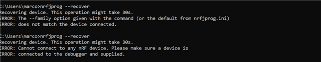

    This is a try to recover (i want to upload the softdevice) with the first having connected only the DK and the second one with both the DK and the nRF52832 breakout.

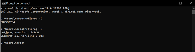

    I see that you are using nrfjprog version 8.5 - could you update your nrfjprog to the newest version?
    It seems that nrfjprog is unable to detect the boards.
    Could you ensure that windows have properly
    What shows up when you connect a board to the PC via USB - does the JLink show up under "Ports" in Device Manager?
