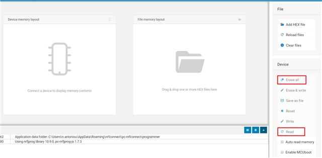

  • You're using the programmer (from nRF Connect for Desktop) to flash your board isn't it? Did you try the "Erase all" and then the "Read" to verify that the memory is empty?
    Did you try an example that do not require softdevice?
    Also check this post

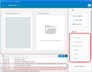

  • I cut a pic below.
    It can't do anymore
    because button is false.
    logs(
    2020-08-17T06:52:37.909Z INFO Application data folder: C:\Users\Administrator\AppData\Roaming\nrfconnect\pc-nrfconnect-programmer
    2020-08-17T06:52:37.985Z DEBUG App pc-nrfconnect-programmer v1.4.4 official
    2020-08-17T06:52:37.985Z DEBUG App path: C:\Users\Administrator\.nrfconnect-apps\node_modules\pc-nrfconnect-programmer
    2020-08-17T06:52:37.985Z DEBUG nRFConnect 3.4.2 is supported by the app (^3.3.0)
    2020-08-17T06:52:37.985Z DEBUG nRFConnect path: C:\Users\Administrator\AppData\Local\Programs\nrfconnect\resources\app.asar
    2020-08-17T06:52:37.985Z DEBUG HomeDir: C:\Users\Administrator
    2020-08-17T06:52:37.985Z DEBUG TmpDir: C:\Users\ADMINI~1\AppData\Local\Temp
    2020-08-17T06:52:38.004Z INFO Using nrfjprog library 10.9.0, pc-nrfjprog-js 1.7.3
    2020-08-17T06:52:38.007Z VERBOSE Could not fetch serial number for serial port at COM1
    2020-08-17T06:52:39.796Z INFO Using nrfjprog to communicate with target
    2020-08-17T06:52:40.057Z INFO Using J-Link Software version 6.80
    2020-08-17T06:52:40.763Z INFO Segger serial: 960119975
    2020-08-17T06:52:40.763Z INFO Segger speed: 2000 kHz
    2020-08-17T06:52:40.763Z INFO Segger version: J-Link OB-K22-NordicSemi compiled Jan 21 2020 17:33:01
    2020-08-17T06:52:40.766Z INFO Core probed: 960119975.
    2020-08-17T06:52:40.766Z INFO Core RAM: 512KiB.
    2020-08-17T06:52:40.766Z INFO Core ROM: 1024KiB in pages of 4KiB.
    2020-08-17T06:52:41.751Z ERROR Error when closing nrfjprog: Error: Error occured when close opened device. Errorcode: CouldNotResetDevice (0x5)
    Lowlevel error: CANNOT_CONNECT (fffffff5)
    2020-08-17T06:52:41.751Z INFO Model: NRF5340_xxAA_ENGA.
    2020-08-17T06:52:41.754Z ERROR Error when getting device info: Error: Error: Error occured when open device long term. Errorcode: CouldNotOpenDevice (0x4)
    Lowlevel error: INVALID_OPERATION (fffffffe)
    2020-08-17T06:52:41.757Z ERROR Error when closing nrfjprog: Error: Error occured when close opened device. Errorcode: CouldNotOpenDevice (0x4)
