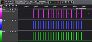

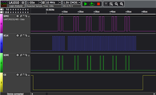

  • I'm sorry I was not clear in describing the issue. good, I had access to a digital analyzer to help me debug and understand spis.
    In the nrf51822 product spec document v3.1, Figure 12  shows the timing digram for spis to send only one byte. I followed the required time delay (between the clock and CS) at the beginning and at the end of the 20 bytes (all has a value of 10) transmission. By using a digital analyzer I saw that master sends only 6 bytes of the 20, and there are a puse in the click line after the first-byte transmission.
    Then I tried to use the required delay at the beginning and the end of each byte t. That seems to let the master sends all the 20 bytes.ransmission
    My question is do I have to pull up the CS after each byte transmission?

    From the logic analyzer screenshot you shared earlier, I would again say that it seems to be the master that is initiating the waiting.
    The slave seems to be replying as expected ( and on time ) for every byte sent by the master. So, I think we will have to keep looking into the master side of this, to find the root cause of this behavior.
    Karl
