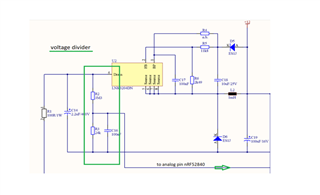

I am developing one project and there we are using ADC (i.e., SAADC in nRF). I have designed the hardware where I am using Capacitor ( C14, 2.2µF) which is connected to Analog pin and my requirement is I have to read the voltage level.
Here I am attaching details and image,
The voltage level of the input capacitor C14, 2.2µF / 400V to the Step-Down controller must be monitored. A voltage divider is used across the capacitor from R2, 3M3, and R3, 24k. The tapped voltage is measured at pin port P0.04 / AIN2 of the nRF52840. The expected voltage at the input of the controller is between 2.35V and 0V. The voltage at the capacitor must not fall below the value of 100V.
This is my requirement can anyone help how to configure SAADC with respect to my requirement.

    Please find my main.c file, I tried below configuration can you please check the file and let me know
    Is this correct or not? asap.

    I tried, I am getting same result -3 and 1023. I think I am still making any mistake or i did not understand it clear.

    Rohit Rajapure said:
    sorry for the late response, I was not well so could not check any messages or notification.
    It is no problem at all, do not worry. I am glad to hear that you are back to health!
    With the SAADC at 10-bit resolution, 1023 = VDD, and -3 = GND. I would at least expect the LSB to fluctuate on your measurements.
    Well, it is hard to say really - you have not told me what your goal is, so it is hard for me to confirm if this is the right approach.
    If you are trying to measure one VDD pin and one GND pin, then you are correct.
    I would also recommend that you make use of the nrfx_saadc driver rather than the legacy nrf_drv driver. Additionally, I would advise you to use the PPI peripheral to connect your SAMPLE_STARt task to a timer event ( like demonstrated in the SAADC example from the SDK ) rather than having a given delay and manually having the CPU start each conversion ( with the call to nrf_drv_saadc_sample. I would not recommend the current approach, as it uses excess CPU resources, and is generally inaccurate and not power optimized at all.
    On a general note, I would also mention that it is less-than-ideal for you to provide the code as you have done here. The large chunks of commented out code should not be included, because it takes the focus away from what you actually would like me to take a look at and provide feedback for.
    In conclusion, I would recommend that you revert to the general setup and approach of the SAADC example from the SDK ( which uses PPI ), instead of the implementation you have now. However, since I do not know exactly what you are trying to achieve, then the current approach that you have implemented might very well suit your purpose.
    If you would like to have the measurements displayed in millivolts ( mV ) instead of raw SAADC outputs then you need to convert them using the formula I referenced in my earlier comment. If you would like to see how battery measurement is implemented in another example, please have a look at the BLE Proximity Example from the SDK.

    Also, I am sharing my end requirement and image below,
    I hope this helps you understand my requirement.
    Looking forward to your reply on this.
    Yes, like mentioned in the original ticket, but what is your required resolution and sampling frequency?
    If you only need to know when the voltage crosses a certain threshold then you might want to look into using the SAADC limits feature.
