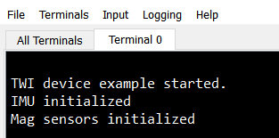

I added a few print functions to trace down the bug. Main function seems to pass through the error checks, twi initialization, and IMU/magnetic sensor initialization functions without issue as per my output in RTT Viewer (see below).
The code seems to get stuck here, where it gets the device ID's. It returns 0x0 for both the IMU and magnetic sensor so I am thinking that maybe the LSM9DS1 is not receiving power. The code seems to recognize that the LSM9DS1 exists because it does not return the "Cannot find the LSM9DS1." error message.

Output:
