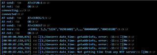

  • Hi Tobjorn,
    Unfortunately yes, its still reporting the same error. The CEREG value says the modem is connected but the error still remains. Is there any way or other example where this could have been implemented for a reference ?
    Adeel.

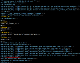

  • This is the output coming up on the screen. I even tried different NTP servers to try and get the error out.
    Adeel.

  • Hi Adeel
    Sorry for the slow response. To be honest I haven't handled much nRF91 support up until now, and have spent some time just to get the tools and basic examples running.
    I will do my best to integrate your changes and get back to you by tomorrow.
    Best regards
    Torbjørn
  • Hi Tobjorn,
    I appreciate your support. You can get back to me tomorrow, no issues :).
  • Hi Adeel
    I messed around with it today, and finally got it to work with some help from the developer.
    You can find my example here:
    https://github.com/too1/mqtt_w_date_time
    It is based on the mqtt_simple example, but I moved all the mqtt functions into a separate file for clarity, and added the date_time calls into main.
    Some things worth noting:
    1) To make date_time.c build I had to make a small change to the code. I explain this in the readme of the repository.
    According to the developer this issue is fixed in the master branch, but was not properly tested in the v1.3.0 tag.
    2) In order to get the time information properly he suggested I set CONFIG_DATE_TIME_MODEM=n in the project configuration (prj.conf). This prevents the library from trying to get the time from the modem, and instead accesses the NTP server.
    3) He also suggested adding some delay between the first call to date_time_update() and date_time_now(), as you can see in my example.
    With these things in place I am able to see the current time printed after the program has run for a bit:
    Best regards
    Torbjørn
