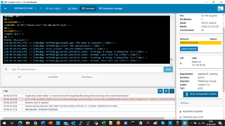

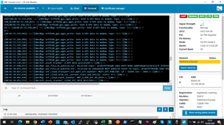

I have bought a Thingy 91 and have connected to the nRF cloud etc. and I am getting the sensor data OK.
The GPS is still not working, I have followed the instructions and it says waiting for GPS data.
This is rubbish and if I don't get this working soon will return for a refund as the product does not work as stated.
I did connect with LTE Link Monitor and there was a connection to the Telefonica network and I can see the GPS details there but not in the nRF cloud.
Please can you help to get this resolved.

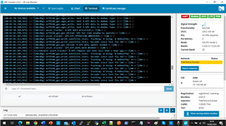

  • We have the same issue and GPS has no fix.(board: Thingy91 1.0.2) I used the pre-compiled hex thingy91_ltem_dfu_2020-04-29_bc7ade8b.hex downloaded from Nordicsemi website and latest modem firmware mfwnrf9160120.zip. It always tracks the satellites, but never got the first fix.

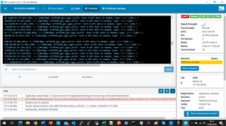

  • Hi Face,
    Are you using the IBasis SIM ? If that is the case then I am afraid it will not work. This is due to the case that IBasis does not fully support eDRX/PSM witch is needed for that example to work properly whit GPS.
    if the above statement is correct then could you try whit a O2 SIM ? This worked for Asif09.
    Asif09 said:
    I have also inserted a new O2 data sim and all is wrkign well now.

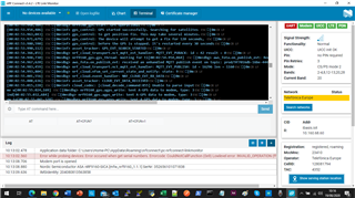

  • Jonathan,

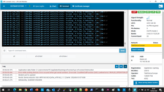

    I tried the GPS project in samples/nrf9160/gps to avoid the affection from LTE(or power saving modes to switch between LTE and gps). The GPS still has no fix. Following is the log and it is tracking 0, 1, 2
    2020-09-21T21:31:49.086Z DEBUG modem << Scanning [/] [1;1H[2JTracking: 1 Using: 0 Unhealthy: 0
    2020-09-21T21:31:49.189Z DEBUG modem << Seconds since last fix 683
    2020-09-21T21:31:49.594Z DEBUG modem << Scanning [-] [1;1H[2JTracking: 1 Using: 0 Unhealthy: 0
    2020-09-21T21:31:49.598Z DEBUG modem << Seconds since last fix 684
    2020-09-21T21:31:50.102Z DEBUG modem << Scanning [\] [1;1H[2JTracking: 1 Using: 0 Unhealthy: 0
    2020-09-21T21:31:50.215Z DEBUG modem << Seconds since last fix 684
    2020-09-21T21:31:50.359Z INFO Modem port is closed
