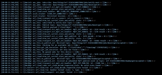

nrf9160dk - There was an error adding your device: nRFCode 40102
Please note about 9 days ago another user reported similar problem but is his case LED3 and LED4 were blinking. In my case after reset I see LED 3 blink and then about 30 seconds later LED 4 is on permanent. I am NOT getting the LED3+LED4 blinking phase.
I am trying to add the DK to my nRF cloud account and I get the following error message: "There was an error adding your device: nRFCode 40102: Ownership code [HWID] is invalid for device [DEVICE ID]." .
I am running the DK with 'nrf9160dk_asset_tracker_ltem_2020-04-29_bc7ade8b' firmware, and the 'mfwnrf9160120' modem.
I have updated the device's certificate which was generated in my nRF account, using the certificate manager in LTE Link Monitor.
I thought I may have generated a wrong certificate so I created a new one and downloaded to my DK a second time.
I stress I have now generated the certificate for this devkit twice and loaded into the device twice successfully
The device has LED4 on permanently and just can't add it to the cloud.
My board is version 0.8.2.
Also note that I have another DK which is version 0.9.0 and that I managed to successfully add to the cloud and can see the data come through.
Look forward to hearing from you
Regards
Mahendra
  • I would like to add that before loading the asset tracking firmware in the programmer application I had clicked the erase button on the right which is one thing different step I did for the first 91 DK that is working for me.
    Perhaps I may have inadvertently deleted the IMEI and HWID to a default value?
    Is there an AT command to interrogate the modem to extract the IMEI and HWID as per the printout on the label?
  • Thanks for the information! I have talked to one of our developers with access to the nRF Cloud database. He noticed there were two certificates registered to the IMEI. You should be able to reconnect now and register. Can you please try?

    Keeping on with this ticket, you will need to open LTE Link Monitor again and then look at what is printed in the output.
    If both LED (LED3 and LED4) are blinking, and the output states:
    020-08-19T14:03:27.088Z DEBUG modem << [00:00:07.905,700] [0m<inf> asset_tracker: CLOUD_EVT_PAIR_REQUEST[0m
    2020-08-19T14:03:27.090Z DEBUG modem << [00:00:07.911,956] [0m<inf> asset_tracker: Add device to cloud account.[0m
    2020-08-19T14:03:27.092Z DEBUG modem << [00:00:07.918,762] [0m<inf> asset_tracker: Waiting for cloud association...[0m
    Then login to nrfcloud.com and click add LTE device. Once connected, only LED4 will be on and static.
    If only LED 3 is blinking, that means that it is still connecting to the network. Please ensure good coverage.

  • Hi Oyvind
    Just a few minutes ago I finally managed to get it to work.
    Thank you for all your help.
    Suspiciously the only thing different I did this time was to send an email to the person who I think could have registered in his account.
    In addition, for the first time I also managed to see LED3 and LED4 blink at the same time. Never seen that before, even when I was playing with the first board
