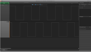

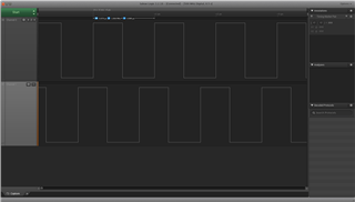

Question 1: How do you use .top_value and nrf_pwm_values_common_t seq_values[] to produce a 50% duty cycle?
I've figured out that for a 50% duty cycle, sequence has to be 1/2 of top value but when you look at these two screen shots you can see that the peak and the trough have different widths. Is that to be expected and is it unavoidable?
Question 2: Is there anyway of starting two separate nrfx_pwm_config_t instances simultaneously?
You can see in the screen shots that the 2nd channel is slightly ahead of the 1st channel. This delay is no doubt caused by the sequential calls to nrfx_pwm_simple_playback to start each of the channels. I guess the only way is to use two of the four channels in one instances of a nrfx_pwm_config_t. If I wanted my 2nd channel to have a duty cycle that was 32x's larger than my first channel, how would I put the sequence array together?
     The nrf_pwm_values_common_t is an array of uint16_t, so I think it's just the raw compare value of the timer. Ie. half your COUNTERTOP value for 50% duty-cycle.
     That's not what your scope show. You've measured a difference in time of two full periods, not a peak and a trough. What you have shown is that there is a variance in the PWM frequency, which could be due to either capacitive loading or an inaccurate clock. IF the HFCLK is running from the internal 64MHz RC oscillator then there is usually some jitter, but I think a more likely culprit is capacitive loading. The Saleae probes are ~10pF and the pin is 3pF, if there's other stuff connected then the capacitance increases further. I suggest you start the HFXO and see if that helps, if it does not then it's definitely due to capacitive loading.
     You can use the EGU to generate an event and connect it to the TASKS_SEQSTART[n] task of both PWM instances (you need to 'fork' the event).
     Do they still share the same PWM frequency (COUNTERTOP)? If so the sequence value must be 32x larger.
