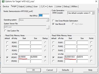

combined uart example and timer example and it does not work.
Hello, I am
I'm a Beginner at developing NRF 51822
My Development Environment
sdk : 12.3
IDE: KEIL v5
SoftDevices : s130
Recently, I've been experiencing a lot of problems combining various functions.
The contents of main.c are combined with uart examples of peripheral and timers examples of peripheral devices.

There were many errors in the process of merging, but the modification of sdk_config.h resolved.

I saw the program stop during the 'uart' operation.
If the operation is normal, the letter 'start :' will appear and wait for input, but only "star" will operate and stop.
However, I have confirmed that deleting 'timer_start();' from my source code will work properly.
Add-
For use with 'softdevice s130', irom and iram have been modified and operated.
Q 1.  Did I set the timer wrong and the program died?
Q 2. Where are the documents describing how to modify sdk_config.h or the function and its contents?
Q 3. I forcibly modified iram and irom for use with 'soft device s130', is it correct to use them like that?

    The IROM1 start is correct. 0x1B000 is the size of S130 version 2.0.1, so that is also the correct start address of the application. The RAM configuration depends on SoftDevice configuration, so if you believe that is too low, you could set the RAM start address a bit higher (and the size a bit lower). Setting it too high is not a problem, provided there is still enough RAM for your application.
