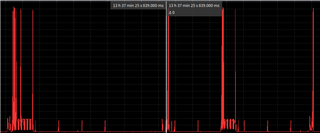

We observe 4 distinct cases:
a) short UDP pulse and no network communication after
after LTE connect you can see modem communications. The selected part is sending the UDP packet. This sending is different from the others - it is shorter/cut off. After UDP send no traffic can be observed untill LTE disconnect (happens off screen). This seems like it is the only case in which RA actually worked.
This is how we would like it to be every time. Consumption of UDP is around 90 µWh, and there is no unnecessary consumption thereafter.

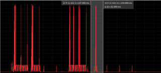

b) short UDP pulse with  network communication after
Similar to above, but as you can see, even after UDP sending, the modem has decided to send something to the newtork. We would very much like to avoid this from happening.
(The spike at the end is LTE disconnect)

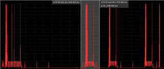

c) long UDP pulse and no network communication after
Similar to case a), but the UDP pulse is longer. This longer pulse consumes around 350 μWh, which is almost 4x more then the short pulse.

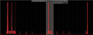

d) long UDP pulse with network communication after
Similar to b), but the UDP pulse is long.
