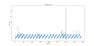

Moreover, I also tried calculating it putting the packets on 2 different serial port (after the trasmission and the reception), appending a timestamp and post-processing it, but the result (for packet bigger than 50B) is quite strange( figure: /resized-image/__size/320x240/__key/support-attachments/beef5d1b77644c448dabff31668f3a47-0514cb2d3e5046b48f0972c4924097bb/Figure_5F00_1.png). Any ideas about these?

  • but the result (for packet bigger than 50B) is quite strange
     What exactly is strange?
    I checked out your graph. What is the X-Axis? Number of bytes in the packet? I don't understand what is strange about it. Is it the steps? How many bytes difference do you use in each sample? Is it the stair shape that you find strange?
    To measure the time between transmission and reception, one thing you can try is to just toggle a pin on the DK when you transmit (right before sd_ble_gatts_hvx()) and toggle a pin when you receive it on the other side, and use a logic analyzer to compare these two signals.
    What exactly is it that you want to measure? I don't know if you are aware about the "connection interval" in BLE and how that works? Basically, the connected devices will only communicate once every connection interval. So you will see a random delay between 0 and <connection_interval> ms.

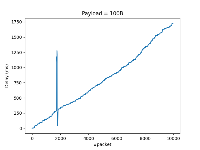

  • Hi Edvin, thanks for the fast reply. I forgot to rename the axis in english. The y-axis is the delay in ms, while the x-axis is only the number of packet (first packet, second packet, ecc ecc), with a payload of length 100B. What is strange for me is that the delay tx/rx improve during the communication, while in theory (as you said) it would be random beetween 0 and <connection_interval> (in the application 7.5 ms).
    Of course I know about the connection interval and all the related stuff of BLE spec: I'm sending 100B over 1Mbps phy (Data Length extension and ATT_MTU size are set to the maximum, so I can send 100B (I have also debugged it with wireshark).
    The problem is that I can use an oscillosope/instrumentation only 1 times a week, and so I would like to find some strategy to compute the delay in a reliable way.
    So, do you agree with me that the figure is quite strange? With the time field of Wireshark can I compute the delay or only the connection interval?

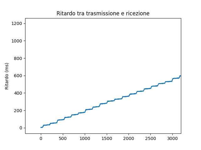

    Based on the pattern that you see, does it mean that if you leave it running, it will take many seconds, and even minutes delay after enough time?

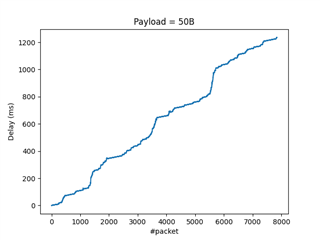

  • Based on the pattern that you see, does it mean that if you leave it running, it will take many seconds, and even minutes delay after enough time?
    Yes. I will post some figure here with different payload size. The strange thing is that now this happens also for payload size < 50B
    100B: /resized-image/__size/320x240/__key/communityserver-discussions-components-files/4/100B.png
    50B: /resized-image/__size/320x240/__key/communityserver-discussions-components-files/4/50B.png
    5B: /resized-image/__size/320x240/__key/communityserver-discussions-components-files/4/5B.png
    I really don't understand why this behavior
