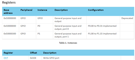

Studying the possibility of using C ++ on the MCU nrf52840, I met an interesting moment in file "nrf52840.h"
I have added a part of the file which gives me some surprise.

So, we have two ports, which are described by the NRF_GPIO_Type structure.
The structure size is 1920 (0x780) bytes.
However, port addresses are listed at 0x300 intervals.
#define NRF_P0_BASE                 0x50000000UL
#define NRF_P1_BASE                 0x50000300UL
It turns out that there is an overlay. I see that there is nothing terrible for me in this, since at the beginning the structure has a huge reserved memory area (1284 (0x504) bytes).
If this reserved area is used to add a second port, shouldn't we then change the structure in the description?
