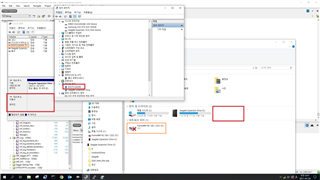

I received a nRF52833 DK (PCA10100) and I was capable to install heart rate example dropping prebuilt hex into the mass storage driver. Later I flashed a led blink test with Segger and after a few tests suddenly my pc (Windows 10) doesn't recognize the board anymore, not even at JLINK device. I don't know if I flashed wrong addresses or what.
The board does not turn any led or be recognized unless if I turn on with BOOT/RESET button pressed, then a "BOOTLOADER D:" usb device ( capacity 128KB) is connected and after 30 seconds it disconnects.
All switchs are normal: power source VDD, trace DEF, VEXT OFF, POWER ON, etc. I double check this.
I compiled secure_bootloader_ble_113_pca10100 and then I drag and drop into the "BOOTLOADER D:" but its disconnects and nothing happend.
