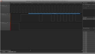

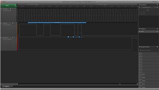

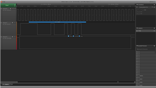

One of the following screen shots is of the low LRCK with SCK and DOUT, (top channel is SCK, next is DOUT, and bottom is LRCK). The other screen shot is a zoom of the same.

    Do you have some logic analyzer traces I can look at? I'm not sure I fully understand the setup.
  • I will try re-posting the pictures here.

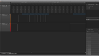

    The following screen shot is a matplotlib.pyplot.plot of 224 of the I2S peripheral's output values of the phone's signal.
    Thank you for your response. I'm still reading it. Let me know if I can provide anything else.
    Thanks for posting the pictures.
    Amplitude is a bit low, but that might be "low volume" on the source. Approx. 100 samples for one period (31,25k / num_of_samples) = ~312 Hz, which is ~25% off.
    The WS signal looks to be approx. 16.5 us, which gives a period of 2*16.5 = 33 us -> ~30 kHz.
    The timing here is a bit off. Can you confirm if you're using the HFCLK or not?
    Again; it is _very important_ that you run using the external HFCLK when testing I2S. The internal 64 MHz RC oscillator can be quite inaccurate..
    Håkon
