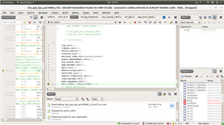

    With that being said, could you show me how you are initializing your timer? I see from the screenshot you have shared that you are calling TASKS_START, but how is the timer configured prior to this?
    If the configuration is incorrect or missing, I would expect that the timer does not start.
    Furthermore, what are you here trying to have your code do? I see that you highlight the LED1 PIN CLEAR code line in your screenshot - but this is not related to the timer in any way. I also see that you are calling a read_freq function in your for-loop, but I do not know anything about what that is meant to do.

  • Hello.  The following are my function calls:
    How to find if the code uses soft device?
    I am editing the existing BPS example. I have added the following code to it.
    static void hfclk_config(void)
    ret_code_t err_code = nrf_drv_clock_init();
    nrf_drv_clock_hfclk_request(NULL);
    static void counter_init()
    // Initialize timer module.
    NRF_TIMER1->TASKS_STOP = 1;
    NRF_TIMER1->MODE = TIMER_MODE_MODE_Counter;
    NRF_TIMER1->BITMODE = (TIMER_BITMODE_BITMODE_24Bit << TIMER_BITMODE_BITMODE_Pos);
    NRF_TIMER1->TASKS_CLEAR = 1;
    NRF_TIMER1->EVENTS_COMPARE[0] = 0;
    NRF_TIMER1->TASKS_COUNT;
    static void read_freq(void)
    NRF_TIMER1->TASKS_CAPTURE[1] = 1 ;
    counter = NRF_TIMER1->CC[1];
    NRF_LOG_INFO("Went here");
    //NRF_LOG_INFO(counter);
    while(counter < 100000)
    while(!(nrf_gpio_pin_read(BTN)));
    while((nrf_gpio_pin_read(BTN)));
    increment++;
    //NRF_LOG_INFO("Went here");
    freq = increment;
    increment = 0;
    //NRF_LOG_INFO(freq);
    hfclk_config();
    counter_init();
    NRF_TIMER1->TASKS_START = 1;
    for (;;)
    read_freq();
    //idle_state_handle();
    You can ignore the LED part. I am just using it as a debug point.

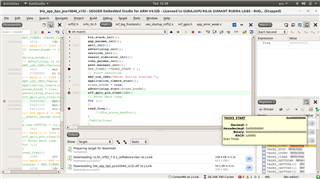

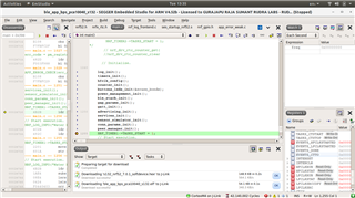

    I see that clock has been started:

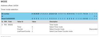

    Timer mode has been set to 1.
    But the CC values are empty. They are not getting incremented.
  • TIMER0-5 mode counter is deprecated? Does that mean we can no longer user TIMER0-5 as a counter?
    Only RTC can be used?

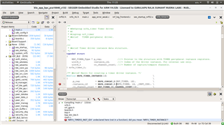

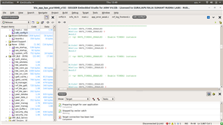

    Is there a particular reason for why you are accessing the timer registers directly, instead of using the drivers provided with the SDK?
    If all you want to do is create a simple timer, then I highly recommend the Application Timer Library, or the TIMER peripheral driver.
