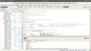

Hello Karl. I am not using the SDK directly and have chosen the registers mode due to this reason. It throws an error.
Hello Karl. The Timer Driver method fails to work.
When I use this,
const nrf_drv_timer_t TIMER_LED = NRF_DRV_TIMER_INSTANCE(3);
It does not compile. Hence I am working directly with the registers.

Are you familiar with the sdk_config.h file and its function?
The compilation error you receive in your included picture is caused by the particular timer not being enabled in the sdk_config.
Without seeing your sdk_config.h it is hard to say for certain, but I would guess that some *_TIMER_ENABLED defines are not set.
Could you check this out for me, and let me know their current value?
Are you able to run the TIMER example from the SDK that I referenced earlier?
If you are, you may take a look in its sdk_config file, to see how the TIMER driver is set up there.

Hello. This is how it looks.
I am unable to run the timer.
I was only able to get the RTC counter working.
