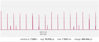

I'm currently trying to use 2 channel SAADC to measure 2 analog input port
I've searched other questions in this forum and referred SDK example
Actually, I could measure 2 analog input using 2 channel SAADC,
but disabling (uninitialization) not working normally.
There is no fault error, but after once 2 channel SAADC enabled
current consumption is measured up to 1.2 mA after uninit()..
so.. is there any method to disable multi-channel SAADC ?
I used SDK 15.3.0 with softdevice s132 6.1.1
Thanks
- D.W Kim
    I'm suspecting that your issue is caused by the EasyDMA. Could you try to reset the peripheral by adding this code after you uninitialize  the peripheral:
    volatile uint32_t temp1;
    volatile uint32_t temp2;
    volatile uint32_t temp3;
    temp1 = *(volatile uint32_t *)0x40007640ul;
    temp2 = *(volatile uint32_t *)0x40007644ul;
    temp3 = *(volatile uint32_t *)0x40007648ul;
    *(volatile uint32_t *)0x40007FFCul = 0ul;
    *(volatile uint32_t *)0x40007FFCul;
    *(volatile uint32_t *)0x40007FFCul = 1ul;
    *(volatile uint32_t *)0x40007640ul = temp1;
    *(volatile uint32_t *)0x40007644ul = temp2;
    *(volatile uint32_t *)0x40007648ul = temp3;
    The code block will reset the peripheral. Note that you need to re-configure all registers before you use the peripheral again.

  • Thanks, Jared
    It works well !!
    There is no additional current.
