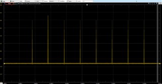

  • Thanks Dmitry! Would you be able to point me to any posts that deal with constructing a 1Mbps waveform with SPI? I am quite inexperienced with the inner workings of SPI moreover, but I'm starting with the examples/peripheral/spi from the SDK. How might I build from this example? I can see how data is transferred but unsure how I would get a nice waveform that I can read on a scope. (Right now the MOSI pin readout from the spi example isn't making any sense to me at all)
  • I placed different values in m_tx_buf but still get these same little ticks across the MOSI pin (29) no matter the value. At first I thought I had a setting wrong in the scope software but I observed the pwm examples with correct waveforms showing up as they would normally. Am I doing something wrong here?

  • You're watching your signal at 4kHz sampling rate, to see 1Mbps signal, you need at least 2MHz sampling rate. Also, NRF_DRV_SPI_DEFAULT_CONFIG has 4Mbps default settings, you need to set spi_config.frequency = NRF_DRV_SPI_FREQ_1M for 1Mbps.
  • Hey good catch Dmitry. After adjusting the sample rate I can start to see some recognizable pulses, and I've managed to construct an appropriate waveform, however the data are still far apart from each other, what do I need to change in order to control the delay after my data has been transferred?

  • Yes! Per your suggestion I was able to construct my required waveform with a proper SPI implementation at the right clock speed. Much thanks!
