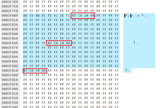

     If your application uses the peer_manager, it will initialize the FDS pages on first power up, but it doesn't necessarily store something there. This is why you see the lines near the top of the flash after you connected to it. You should see the same lines even if you do not connect to it at all. If you want to investigate further, you can read back the flash using either nRF Connect -> Programmer or nrfjprog (nrfjprog --readcode my_flashdump.hex). If you open that hex file in a text editor, you can check the content of the FDS pages like this:
    Search for "DEC0ADDE" (DEADC0DE in reverse byte order). It will have a few occurances in your application region, and then N occurances near the end of the file, where N matches the number of FDS pages in your application (N = 3 by default in the later SDKs, but since you are using the nRF51, this may vary). The word after dec0adde is either FF011EF1 or FE011EF1, where FF011EF1 refers to the swap page, and FE011EF1 refers to data pages.
    What you should see, if the application didn't write anything to the FDS pages, the area after DEC0ADDEFE011EF1/DEC0ADDEFF011EF1, and to the end of the page contains records. If they are all 0xFFFFFFFF, then it means that the FDS is only initialized, but there is no data written to the flash.

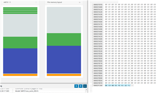

    yes indeed I had seen that flash pages were reserved and used from the end, either just before the bootloader if it exists, or at the very end of the memory without a bootloader.
    I have 3 reserved pages with a few bytes established. I had clearly identified the bonding page that evolves after a pairing. The other 2 I don't know what they are for.
    0x3F400 - 0x3F7FF : ?
    0x3F800 - 0x3FBFF : bonding
    0x3FC00 - 0x3FFFF : ?
    I do test without bootloader to more lisibility.
    I analyzed the memory with an intel HEX editor from a read with nrf connect. I can see the DEADCODE data.
    it is therefore the page with the bonding information that I want to bypass (see attached)
    memory after 1st boot. I can see data page
    location of data after bonding
    So I correctly locate the page, now the question is how to redirect the accesses (R / W) on RAM
