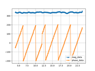

2. sampling offset
I have plotted the result as shown in figure below:
The x axis is time, the data starts at 4us indicating the start of reference period. I mapped the data from 4us to 24 us with 0.125 spacing. This maybe is wrong but I don't know for the moment what is the right timestamp for the I/Q sample data.
You can see there is a disconnection from 12us when the reference period ends. Is this the sample offset indicated in the production specification? I configured to 3 (3@16M = 0.1875us, which is probably not enough. I have shift the right part by 1us on the timing, which makes the wave looks continuously.
Could someone help me to understand when those samples are taken exactly ? Thanks a lot!
    There is an 1-us gap after reference period, it's not related to sampling offset. The documentation is not clear about this point, but there is a white paper with better description.
    You don't need to figure out an exact times at this moment. When you'll have a prototype hardware, take a measurement at 0.125us rate and you will see the best sampling point for your array and switch IC.
