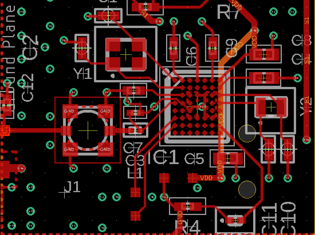

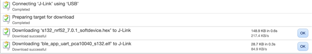

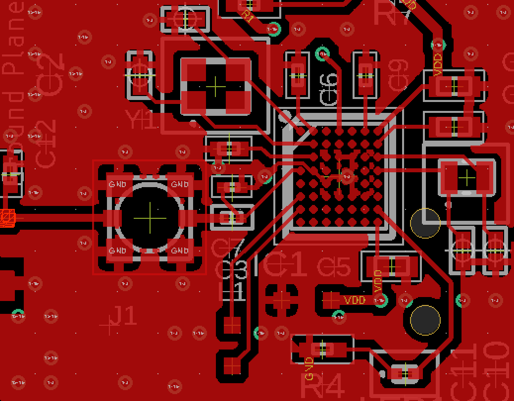

I am using a custom board with nRF52832 WLCSP and I am trying to program it via SWD using NRF52DK PAC10040, and SES for programming SDK_17.0. I followed 2 layer reference design of NRF52832 CIAA, however the program still cannot be flashed onto the MCU even though it is showing on SES that it was programmed successfully. The connection for SWD programming followed is based on this link. Attached is the schematic and layout. Any suggestions are much appreciated, thank you.
    How do you determine that the application isn't properly flashed? Could you try using nrfjprog and program it directly with the log option:
    nrfjprog --program YOURHEXFILE --sectorerase --log

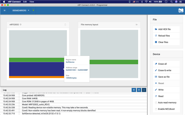

  • Thank you for your respond. Yes, below is the log message. I am using this program from Nordic GitHub (link) to test BLE and ADC of my custom board.

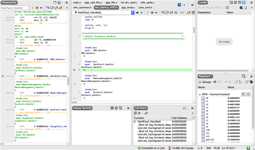

    I tried to debug with SES, and it stopped at timers.init() and stopped at HardFault_Handler(). Do I need to change one of the timer parameters in the sdk_config ? Please advise what possibly caused this issue. Please refer to image below for details on the debugging, thank you.
    Ok, so the program is actually flashed properly since you're able to use the debugger in SES. I flashed a nRF52 DK with the example and it worked without any issues. Have you made a custom board file for your custom board? Note that resuming a softdevice application in debugging after you've halted it will result in error. You would have to restart the application between every time you've paused it during debugging. Exactly at what step in timers_init() does it hardfault?

    It turns out that the custom_board.h file was the issue. It was still defined as pca10040.h. However, currently the program does not work after power restart. Could it be the button defined in the custom_board.h that causes the issue ? Since my board does not have any button. Below is the attached header file for the custom board. Please advise, thank you.

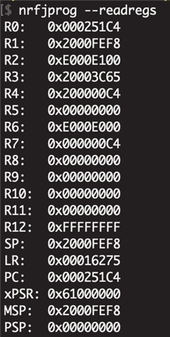

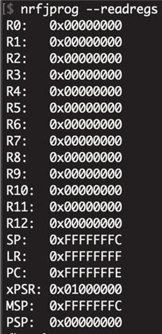

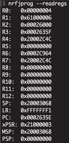

    After further inspection, I find that there are some discrepancies in the register. My findings are as follow :
    1. Below is the register read after flashing the program via SES where the BLE application is running properly.
    2. Below is the register read after power restart where the BLE cannot be detected on the mobile phone.
    3. However, the program runs again after I did verify in SES (target --> verify) or when I connect it on nRF Connect Programmer.
    4. When programming the device with hex file via nrfjprog --program ble_app_uart_pca10040_s132.hex --sectoranduicrerase, the read register is also different. It becomes as follow :
    It looks like there are errors in my setup, please advise what I did wrong, thank you.
    Reno

    The content of the registers is dependent on when you check them in the execution of the program and what compiler that is used to build the application. It doesn't really tell us what the error is.
    Build an unmodified example from the SDK in debug mode and flash it to your custom board. The only thing that you should modify is the custom board map that maps the pins correctly. A error message should then be outputted when the application hits an error.
    Note, that your original problems statement was that it wasn't flashed properly to the board. But it seems that the application is indeed flashed properly, but that it's running into some run-time error. Exactly what error is what we're trying to figure out.
