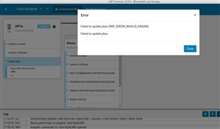

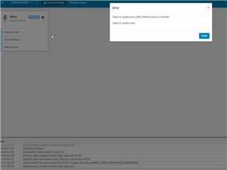

The advertised device can be found on iOS's nRF Connect App as well as with Android. The advertised name of the nRF52 is correctly received. However neither can I connect nor read the advertised services. Both apps show "No service" in the pre-connection phase. When I try to connect with iOS I immediately get the following error:
As you can see the smart phone seems to be "somewhat" connected (background of picture). The app on the phone still says "Connecting...". Some seconds later the connection terminates.
On Android I get "Error 133 (0x85): GATT Error" but nothing more.

    Thank you for the update. I got my hands on an iPhone and tested myself. It seems like the latest Bluetooth Low Energy application has a bug, where it won't respond to the connection that the iPhone initiates for some reason. I have reported this internally, and we are looking into it. Thank you for notifying us about this!
    What iPhone model are you seeing this issue in?
    As for the Android issue, I would need to know what Android device and Android version this is to help you further. I think it should work if you retry a few times, as Error 133 is rather common in some Android devices.
    You can try programming the "default" ble_app_hrs peripheral example in our SDK onto your Dongle, as that should work as intended and lets you read battery level + heart rate as well.

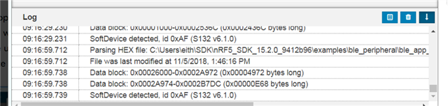

    I built the binary with SES and it is called ble_app_hrs_pca10059_s140.hex and built using SDK v17.0.0. Using the nRF Programmer app I read out the memory of the nRF52840 then clicked "write" in the Device section. Judging by the colored bars the hex is only the app w/o the soft device. I am then asked for the ID of the Softdevice. The latest version number available in here is "0xAE (s140_nrf52_6.1.0)" which is rejected. From what I see in the readmes of the SDK the S140 should be version v7.0.1 and thus ID 0xca. I then added the file 'components\s140\hex\s140_nrf52_7.0.1_softdevice.hex' manually from the SDK directory and wrote both files to the device which apparently finished without error. nRF52840 is blinking during advertisement.
    I can now see the advertised HRM device and can connect w/o errors - but it is not showing any services. The same holds for the nRF Toolbox app.
