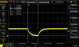

i have a strange issue with my analog input.
Every few seconds (not the same database) my signal is getting pulled low.
But i dont know why. The external signal is stable, i tested it with a oscilloscope.
I meassure the voltage of a piezo ceramic.
please see my oscilloscope print. It looks like a discharge of my filter cap and after thati charges again.
I am pretty shure that is is not related to the external circutry.
I use P0.03 as analog input
Any ideas?
