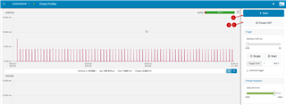

PPK measurement is not started or not started correctly
I uses the NORDIC project saadc_low_power. A counter was built into this so that only a defined number of samples are carried out.
Measuring current on an nRF5 DK while debugging.
Here are the code extensions
#define MAX_SAADC_SAMPLE_CNT ( 1000 )
static uint32_t saadc_sample_cnt = 0;
if( saadc_sample_cnt < MAX_SAADC_SAMPLE_CNT )
saadc_sample_cnt++;
nrf_drv_saadc_sample(); //Trigger the SAADC SAMPLE task
Both variants work with the debugger.

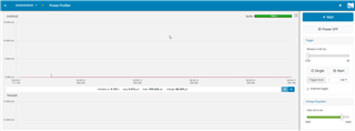

If max Sample 1000, the measurement works - see file saadc_low_power_counter_1000_okay.png
If max Sample 100, the measurement does not work - see:

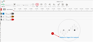

Why is the test not working at 100. This can also be seen on the GPIO port.
Many thanks in advance
Many greetings

  • Hello, Werner!
    Could you try to declare saadc_sample_cnt as volatile and see if that helps? Like this:
    static volatile uint32_t saadc_sample_cnt = 0;
    As the variable is modified by an interrupt routine the volatile keyword should be used.
    Carl Richard
  • Hello Richard,
    nothing has changed,
    Where can I pick up this signal with the logic analyzer?

    2020-09-10T12:16:28.662Z DEBUG HomeDir: C:\Users\Loser
    2020-09-10T12:16:28.662Z DEBUG TmpDir: C:\Users\Loser\AppData\Local\Temp
    2020-09-10T12:16:29.328Z VERBOSE Could not fetch serial number for serial port at COM1
    2020-09-10T12:16:42.066Z INFO Validating firmware for device with s/n 000682858949
    2020-09-10T12:16:42.068Z INFO PPK closed
    2020-09-10T12:16:42.886Z INFO Opening device with s/n 000682858949
    2020-09-10T12:16:42.888Z INFO PPK opened
    2020-09-10T12:16:42.888Z INFO Initializing the PPK
    2020-09-10T12:16:43.630Z INFO SEGGER serial: 682858949
    2020-09-10T12:16:43.631Z INFO SEGGER speed: 2000 kHz
    2020-09-10T12:16:43.631Z INFO SEGGER version: J-Link OB-SAM3U128-V2-NordicSemi compiled Mar 17 2020 14:43:00
    2020-09-10T12:16:45.153Z INFO PPK started
    2020-09-10T12:16:47.446Z INFO DUT OFF
    2020-09-10T12:16:50.827Z INFO Average started
    2020-09-10T12:16:53.341Z INFO DUT ON
    2020-09-10T12:17:00.275Z INFO Average stopped

    With regards to the logic analyzer I must come back to you tomorrow.
    Carl Richard
  • Hello Richard,
    I use SDK 17;
    Just use the  logic analyzer to see if and when the interrupt routine rtc_handler is called
    Werner Loser
  • Hello, Werner.
    I can confirm that I'm not seeing the interrupt routine firing either. Looking into it.
