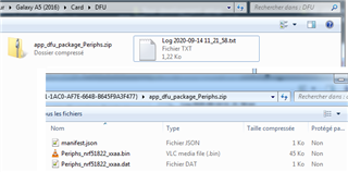

When I go to the smartphone folder, the ZIP file is there and with the right content.
On the card side, it is an NRF51822 (the same like previous working few weeks ago, it hasn't changed). I currently have a Jlink connected and the log indicates that the software is started. Besides, I can connect with NRF connect.
I tried with another smartphone in version 9.0, I have the exact same problem.
While looking on the forum, I saw that there was possibly that it could be the native file manager, I installed 3 different utilities without success (file manger, total commander). Problem is the same. I have the same error.
Please see attached log of smartphone and screenshot of file/folder.
I extract zip fil to verify integrity, it's OK, .bin is correct.
I don't understand what the problem is. Have you an idea ?

E	11:09:04.677	[DFU] Opening file failed: Application file Periphs_nrf51822_xxaa.bin  not found.

    app_dfu_package_Periphs.zip
  • If you open the manifest.zip file inside, you can see that the file names contain a space at the end.  Check if your script does not contain any spaces there, you may also try to removing the spaces manually and replace the manifest.json file with the modified one.
        "manifest": {
            "application": {
                "bin_file": "Periphs_nrf51822_xxaa.bin ",
                "dat_file": "Periphs_nrf51822_xxaa.dat "
    Yes indeed there is a space after .bin and .dat in .json file (I had indeed not seen it), but the files do not have spaces, it is very surprising.

  • Hello
    For the "space" caracter added to file name, I think I find the reason.
    I run batch script on windows. I write batch with parameters like path of hex file (because I have several hex to manage). In my batch, I verify each command by an echo, and all is right.
    Then, these parameter have a native "invisible" space on variable (find in forum cmd / batch), but when use by windows, the "space" is automatically removed, then I not see it (ex with echo).
    However, if the variable is passed to nrf_util, the space is conserved because it is a python script and not a windows management. I supposed the file extension (hex) is replaced (into python script) by BIN and DAT extension and the extra space is keeped.
    So,
    - in .json file, there is space because it is generated by python script
    - in windows file system, the space is automatically removed ! (I test it by adding manually space, it is not possible, windows remove it immediately).
    Regards
