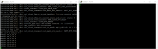

    The next question is that I'd like to get the Thingy 91 printing to serial. Preferably without connecting to it in cloud but right now it doesn't seem to for some reason. I tried to use it out of the package and I tried: Programming usb_uart_bridge on the nrf52 then ltem on the nrf91 and then connecting to it in cloud:
    I have connected to both ports. The first at 115200 and the second at 1000000 as specified in documentation.
