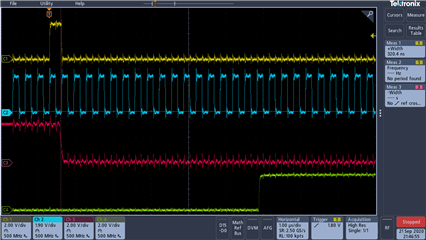

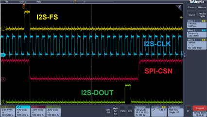

    Here's an oscilloscope trace
    Once SPI-CSN goes low, I want it to go high again after 10 clocks of I2S-CLK (10 is just a number I chose for test - The actual implementation will use 128 clocks)
    It doesn't actually go high until after 18-19 clocks, depending on whether you count the one that occurs at the same time that SPI-CSN is going low.  And its not always the same number - sometimes is 16 and other times 20.
  • Thank you for the detailed explanation, I think I understand what the issue is now.
    There might be a race condition somewhere.
    I suggest you map the SPI-CSN transition from low to high to a separate GPIO pin and see if it will trigger the transition correctly, I'm curious to see what happens when there's only one GPIOTE channel controlling the pin during this transition.
  • Using a separate pin for low-to-high transition did not fix it.
    The green trace is this new pin (SPI_CSN2_PIN).  There are still 17 clocks instead of 10 between CSN going low and CSN2 going high

    What do you think the race condition may be?
  • By the way, I tested at half speed (I2S-CLK set to 1.536MHz instead of 3.072MHz) and that seemed to work.  The CSN pin goes high after 10 clock cycles.
    Isn't this much slower than expected?  I would think from your initial response that the GPIOTE/PPI circuits should be able to handle signals up to 8MHz or so.
