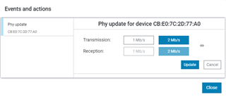

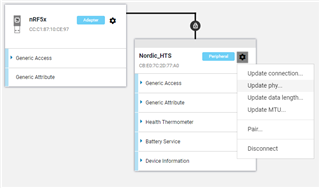

Windows Tool to force a BLE host to request a 2M PHY connection to a Nordic device supporting it
To the kind attention of Nordic support team,
We are doing EMC pre-tests of our products using your nRF52833 .
At this stage, nRF52833 device is triggering itself a phy update request when in BLE mode, in order vto switch to 2 M PHY.
From Lab the said it would be handy to control the PHY update using a BLE host instead.
So, do you know any Windows tool we can use to force a BLE host to generate a phy update request
event in a device, so that host is able to switch between 1 M PHY and 2 M PHY when desired?
Should we build such an Host, using one of your board as an adapter and modifying one of your SDK samples?
