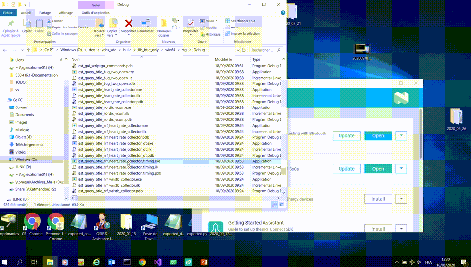

See the video:
So the fact that "nRF Connect - Bluetooth Low Energy" is opened apparently really makes device discovery faster. Later, for our devices, it also makes data acquisition faster, meaning that witout "nRF Connect - Bluetooth Low Energy" being installed and running on the computer, we cannot reach the throughpout we need for our applications.
