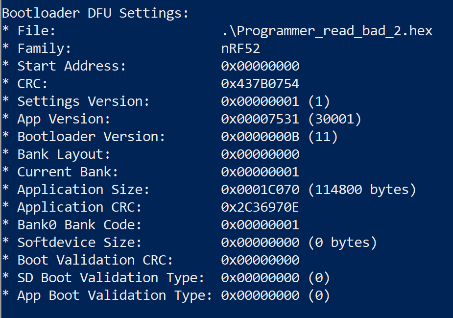

    I will upload the bootloader settings page hex files too, in case it´s interesting.good_btl_settings_segment.hexbad_btl_settings_segment.hex
  • Ah, that was a convenient tool (the nrfutil settings display).
    I am attaching the screenshots of those readings.
    It seems like the settings version is 1 instead of 2, and boot validation crc is missing in the instance that is not working.
    Not working (after the DFU update of SD):
    Working (when programmed with SD v7 from beginning):
    nrfutil displays the settings as if it followed the Settings version 2 format. CRC boot validation of app is always enabled in 15.2.0 bootloader.

  • nrfutil displays the settings as if it followed the Settings version 2 format. CRC boot validation of app is always enabled in 15.2.0 bootloader.
    I´m not really following, how do you mean? Do you mean that it´s not displaying the boot validation CRC even though it exists because it´s parsing Settings version 1 in Settings version 2 format?
     Yes, correct. nrfutil v6 assumes the setting format corresponds to version 2 instead of checking the actual settings version number.
    Here's the difference between version 1 and 2:
    mk2 said:
    I did update SD+bootlader, otherwise I´m pretty sure the application wouldn´t run right?
    Yes, the bootloader update is required when you do a major Softdevice update. It's just that I would have expected the settings version number to be set to 2 after having updated to the new bootloader.
  • I found the root cause. We missed updating the NRF_DFU_SETTINGS_VERSION macro from 1 to 2 in the makefile for the bootloader project (although it was updated to 2 in SES). Fixing that solved the issue.
