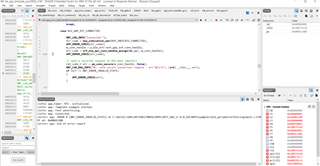

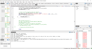

  • Hi
    No. You can take a look at Heart Rate Application use Just Work pair and secure characteristics as
    I have added in mentioned code in the main.c but getting an error
    (static declaration of 'set_security_req' follows non-static declaration).
    So I changed like this.
        ret_code_t              err_code;
        security_req_t level;
                                              (const uint8_t *)DEVICE_NAME,
                                              strlen(DEVICE_NAME));
        /* YOUR_JOB: Use an appearance value matching the application's use case.
           err_code = sd_ble_gap_appearance_set(BLE_APPEARANCE_);
           APP_ERROR_CHECK(err_code); */
        ble_gap_conn_sec_mode_t * p_perm;
        p_perm->lv=2;
        p_perm->sm=2;
        set_security_req_1(SEC_JUST_WORKS,p_perm);
    void set_security_req_1(security_req_t level, ble_gap_conn_sec_mode_t * p_perm)
        BLE_GAP_CONN_SEC_MODE_SET_NO_ACCESS(p_perm);
        switch (level)
            case SEC_NO_ACCESS:
            case SEC_OPEN:
                BLE_GAP_CONN_SEC_MODE_SET_OPEN(p_perm);
            case SEC_JUST_WORKS:
                BLE_GAP_CONN_SEC_MODE_SET_ENC_NO_MITM(p_perm);
            case SEC_MITM:
                BLE_GAP_CONN_SEC_MODE_SET_ENC_WITH_MITM(p_perm);
            case SEC_SIGNED:
                BLE_GAP_CONN_SEC_MODE_SET_SIGNED_NO_MITM(p_perm);
            case SEC_SIGNED_MITM:
                BLE_GAP_CONN_SEC_MODE_SET_SIGNED_WITH_MITM(p_perm);
        return;
    Is this the correct way to call set_security_req?
    If you want the device to send the pairing request to mobile to allow pairing, you can add the code in the BLE_GAP_EVT_CONNECTED event. If the users cancel the pairing request from the peripheral on mobile, they cannot read/write characteristics.
    When I connect the device I get the following error.
