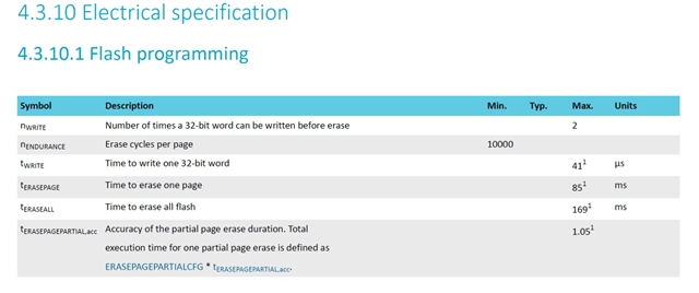

I would like help in understanding the limitations of the NVRAM. The documentation for the nRF52840 and the nRF52832 are different. This is what the nRF52840 reads:
Nvram write 52840 doc
Do I understand correctly that, for any word in a 4K block, it can only be written twice before the entire page must be erased?

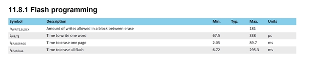

The nRF52832 seems to have a different limitation:
nvram writing nRF52840
This is more complicated. Here the page is divided into 512 byte blocks and the limitations is 181 writes per block before page erase is needed. Here nothing is said about a 32 bit word write.

  • Do I understand correctly that, for any word in a 4K block, it can only be written twice before the entire page must be erased?
     Yes, this is true for the 840. But more specifically the limitations is that you cannot write 0 to the same bit more than twice. In theory the flash allows 8 programs to the same address (but still the same bit cannot be programmed to ‘0’ more than twice). Can you point me to what file/line you are looking at for gazell pairing that does the writes? Thanks

    Hello Runar, Ah, not being able to attempt to write 0 more than twice as opposed to not being able to write a 32 bit word more than twice, puts an entirely different light on the limitation. Presumeably, if the bit written 0 the first time, contains a 1 in the next 7  writes, that will be OK?
     Yes, that's my understanding as well. Did you find time to check the write routine? I am afraid I did not this week, sorry for the inconvenience. Regardless I will register this write routine (the gazell part) as an internal issue so the SDK team can take a look. I have a feeling this is something that was not considered when porting the library to the new chip/platform.
