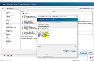

  • Hello Ricardo,
    The problem is the RAM setting you said. Try using the settings shown in the screenshot below. Those should work with the xxAA variant.
    Vidar
  • Hi Vidar,
    In the meantime I had already fixed this by trial and error, but without really understanding what I was doing.
    After setting RAM_PH_SIZE to 0x4000, I was following the messages in the logs and ended up using
    RAM_START=0x200025d0
    RAM_SIZE=0x1A20
    although the log messages were saying that RAM_START should be 0x200025e0, it would then give an error saying that ram start should be changed from 0x200025e0 to 0x200025e0 (yes, that's right - the values was already set as suggested and then there was a suggestion to change to the same value).
    So then I tried with 0x200025e0 and it worked, but my confidence level on this "solution" wasn't great, and couldn't figure out how to calculate these values properly.
    I tried the values from your suggestion and it works without complaints, so I will use those instead of mine.
    Would be interesting though if you could explain how you calculated these values?
    Ricardo
  • Hi Ricardo,
    It is correct to set the RAM size to 0x1A30 as you did initially. I reduced that size by 0x80 bytes to leave room for a "no-init" section at the end of RAM because I forgot that it's not used by the bootloader anylonger (used up until SDK 11).
    Calculation: RAM_SIZE = total RAM size - ram start = 0x4000 - 0x25d0 = 0x1a30
