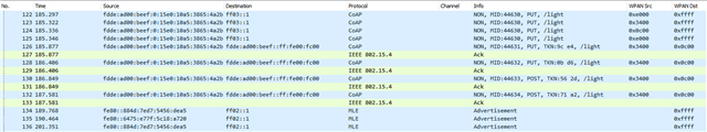

    I have created a modified version of simple_coap_client for you that supports both PUT and POST message types. You need to specify the IPv6 address of the server as a string in the top of the main.c file (coap_post_peer_address_string variable) for unicast messages to work. Press button 1 on the DK to send a unicast POST message to the specified address, button 2 to send a multicast PUT message, and button 3 to send a unicast PUT message to the specified address.
    7673.simple_coap_client_post_put.zip
    I tested this towards the simple_coap_server example, by modifying light_request_handler in thread_coap_utils.c to accept both POST and PUT messages:
    if (otCoapMessageGetCode(p_message) != OT_COAP_CODE_POST &&
        otCoapMessageGetCode(p_message) != OT_COAP_CODE_PUT)
    This sniffer trace shows all message types working well:
    Jørgen
