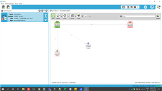

Now I am using Digi's XBee 3 module.
I am seeing following info prints in RTT viewer.

I am using channel No. 16 for network forming in Digi's module, and the same channel is used in nordic (Router) too.
Digi's module has ZigBee mesh network firmware and using ZigBee stack profile 2.
In Digi's network monitoring tool (xctu) I can see nordic as a router but I think it repeatedly connecting disconnecting as shown in the above prints.
You can see the following screenshot of xctu monitoring window where you can see 2 nordic routers and 1 end device but they are not connecting the network but I can see them in the monitoring window.

Is the XBee device using Install Codes (ICs)? What SDK version are you using? 4.1.0?
Edvin
Yes, xbee module requires install codes.
I am using nordic sdk is 4.1.0
