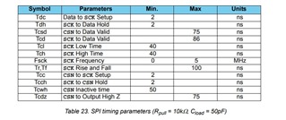

My sck frequency will be 5Mhz.
Accordingly, nrf24l01 + mcu or Rpull = 10kohm and Cload = 50pF
How should I connect according to the SPI time parameter?

Regarding connecting the nRF24L01p you can probably just connect that as long as you make sure the wires is not to long. You could also reduce the frequency to make it more robust.

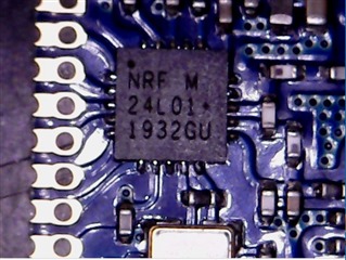

Do you think my nrf is original?
The person I bought says it's original.
Can you please check it?
Seller link: http://www.ebyte.com/en/product-view-news.aspx?id=113
Unfortunately I am not able to tell if it is a fake or note. Even production codes are duplicated...
