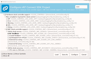

Things we have tried that have been unsuccessful on the nRF52833:
  • Enabled/Disabled RTT
  • Manually setting/resetting NRF_CLOCK registers for HFCLK
  • Using Zephyr Bluetooth samples to see if it was an RF stack issue
Has anyone ran into this problem and come up with a solution? Is there a kconfig option that might be causing this? We've been focused on the HFCLK, however, it proves to work successfully on the 833 when the J-Link is connected, so should we be looking elsewhere?
