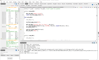

  • Hi ,
    I have tested what you have said. It working.
    Now I am trying to add this part to my project but getting the following Issue. Can you please check?

  • o some function returns an error that has the name NRF_ERROR_INVALID_LENGTH. Did you check what function that returned this value?
    Yes, I have checked and this is function returning an error.
        rc = nrf_fstorage_write(&fstorage, 0x3f000, SNV_Data, sizeof(SNV_Data), NULL);
        APP_ERROR_CHECK(rc);

    I am sending hard code value but still getting same issue.
        char      SNV_Data[]   ="Hello";
        NRF_LOG_INFO("Writing \"%s\" to flash.", SNV_Data);
        rc = nrf_fstorage_write(&fstorage, 0x3f000, SNV_Data, 5, NULL);
