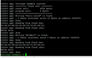

  • I am trying to save different data in the same location but getting different data. Confused
        char  m_hello_world[]   ="hello world";
        NRF_LOG_INFO("Writing \"%s\" to flash.", m_hello_world);
        rc = nrf_fstorage_write(&fstorage, 0x3f000, m_hello_world, sizeof(m_hello_world), NULL);
        APP_ERROR_CHECK(rc);
        wait_for_flash_ready(&fstorage);
        NRF_LOG_INFO("Done.");
        rc = nrf_fstorage_read(&fstorage, 0x3f000, m_hello_world_f, sizeof(m_hello_world_f));
        NRF_LOG_INFO("Reading from flash hex:");
        for(uint8_t i=0; i<sizeof(m_hello_world_f); i++)
            NRF_LOG_RAW_INFO("%02x:", m_hello_world_f[i]);
        NRF_LOG_RAW_INFO("\r\n");
        NRF_LOG_INFO("Reading from flash char:");
            NRF_LOG_RAW_INFO("%c", m_hello_world_f[i]);
        NRF_LOG_INFO("done");
        char m_hello_world_1[]="AllWell";
        NRF_LOG_INFO("Writing \"%s\" to flash.", m_hello_world_1);
        rc = nrf_fstorage_write(&fstorage, 0x3f000, m_hello_world_1, sizeof(m_hello_world_1), NULL);
        rc = nrf_fstorage_read(&fstorage, 0x3f000, m_hello_world_f, sizeof(m_hello_world_1));
  • You don't erase the page in between.
    I have tried to say several times that when you write to flash, you can only change bits from 1 to 0. That means if you write a byte 0x0F to a byte that was already 0xFF, then it will have the value 0x0F after you write. If you write the byte 0xDD to a byte that already have 0xFF 0x0F,  then it will end up with the value 0x0D. That is how flash works. you need to erase the page using sd_flash_page_erase(), which will clear the entire flash page, and set it to all 0xFF.
