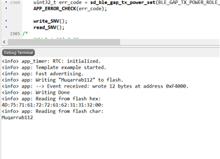

  • Hi
    It's STRANGE. I have changed the initializing value and its work.
    char      SNV_Data[]   ="Muqarrab112";
    char Test_SNV_Data[]   ="Muqarrab112";

    What does it say about NRF_ERROR_INVALID_LENGTH? It explains two scenarios, and a hint is that the issue was not that the length was 0, because len was 5. So it is related to the length, right?

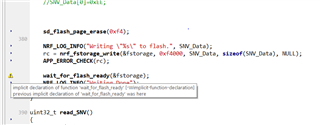

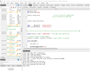

    1-I have made these functions to read/write. As per your instruction.
    char Test_SNV_Data[]   ="11223344556";
    /////////////////////////////////////////////////////////////////////////////// SNV
    void write_SNV()
        ret_code_t rc;
        //SNV_Data[0]=0xEE;
        sd_flash_page_erase(0xf4);
        NRF_LOG_INFO("Writing \"%s\" to flash.", SNV_Data);
        rc = nrf_fstorage_write(&fstorage, 0xf4000, SNV_Data, sizeof(SNV_Data), NULL);
        APP_ERROR_CHECK(rc);
        wait_for_flash_ready(&fstorage);
        NRF_LOG_INFO("Writing Done");
    uint32_t read_SNV()
        ret_code_t rc;
        rc = nrf_fstorage_read(&fstorage, 0xf4000, Test_SNV_Data, sizeof(Test_SNV_Data));
        NRF_LOG_INFO("Reading from flash hex:");
        for(uint8_t i=0; i<sizeof(Test_SNV_Data); i++)
            NRF_LOG_RAW_INFO("%02x:", Test_SNV_Data[i]);
        //    NRF_LOG_INFO("Reading from flash char Hex %h :",Test_SNV_Data[i] );
        NRF_LOG_RAW_INFO("\r\n");
        NRF_LOG_INFO("Reading from flash char:");
            NRF_LOG_RAW_INFO("%c", Test_SNV_Data[i]);
        NRF_LOG_INFO("Reading Done");
    Why I am getting this warning?
