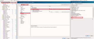

I have written these 3 functions to erase/read and write.
/////////////////////////////////////////////////////////////////////////////// SNV
const uint32_t f_addr = 0x000FF000; // Last page start address 255
// Create a pointer to that address
uint32_t * p_addr = (uint32_t *)f_addr; //cast f_addr to a pointer
uint32_t erase_SNV()
    NRF_LOG_INFO("Memory Erased");
    return sd_flash_page_erase(255);
uint32_t write_SNV(int address,uint8_t value)
    uint32_t val;
    val=value;
    NRF_LOG_INFO("Data Write in Flash");
    ret_code_t err_code;
    err_code = sd_flash_write(p_addr+address, &val, sizeof(val));
    return err_code;
uint32_t read_SNV(int address)
     NRF_LOG_INFO("The Data read from flash is: %d", *(p_addr)+address);
     return *(p_addr)+address;
When I write any value from address 1 it gives following wrong output(0 1 2 3).
    write_SNV(1,11);
    read_SNV(1);
    write_SNV(2,12);
    read_SNV(2);
    write_SNV(3,13);
    read_SNV(3);
  //  read_SNV(0);
    read_SNV(1);
    read_SNV(2);
    read_SNV(3);
But When I start address from 0 it gives the right values.
    write_SNV(0,10);
    read_SNV(0);
    write_SNV(1,11);
    read_SNV(1);
    write_SNV(2,12);
    read_SNV(2);
    write_SNV(3,13);
    read_SNV(3);
    read_SNV(0);
    read_SNV(1);
    read_SNV(2);
    read_SNV(3);
How can I save values in rondom addresses?
Thanks!

     I guess your wait_for_flash_ready() doesn't return, which suggests that you don't get the event. Is that correct? From where do you call Charcteristics_9()? Inside an interrupt, by any chance? Try to call it from your main() function. Does it get executed then?
  • Did you find the reason for your previous issue? that the write function returned invalid length?
    I have changed the data length (set ~12) and it's working now.
    I have called the function in main and its working. But when I write on characteristics and called the same function it does not work. Does any suggestion please?

    When debugging, do you see any kind of error code in either the write_SNV() or read_SNV() functions?
    No, I have not seen any error.
    The issue is when I connect the device and call the read/write function I got no response.

  • Hi
    Have you set the DEBUG define in your preprocessor definitions? This is necessary in order to see any of the debug logging information in your log backend. To do so, right click your project in SES, and open Options..., then set the build configuration to Common, find the Preprocessor Definitions tab, and add DEBUG to the bottom here. See the attached picture for reference.
    Simon
